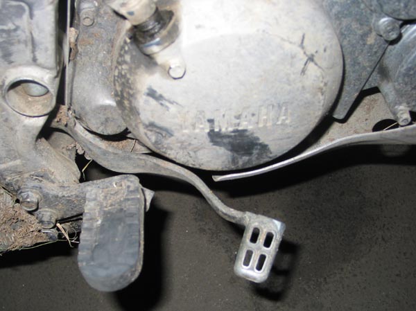

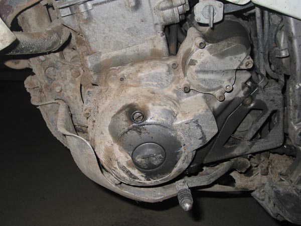

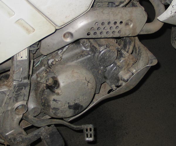

The XTZ sumpgard will not fit strait on because the frames are different. It will probably be a little to short to (even Touratech is to short).
Compare the pictures below to the pictures in my previous links.

I see what you mean, but it would be better then nowt. It does however look like teh XTZ doesnt have any frame under the engine, is this right?

Hoke
Joined: 07 Feb 2005
Posts: 56
Location: Stockholm, Sweden
PostPosted: Fri Jan 05, 2007 3:23 pm    Post subject: Reply with quote
No, i don't think there where any.
The Sump guard was mounted to the frame in front of the engine, and in the back where the footpegs are.
That sumpguard was actually very good -i tested it alot Laughing

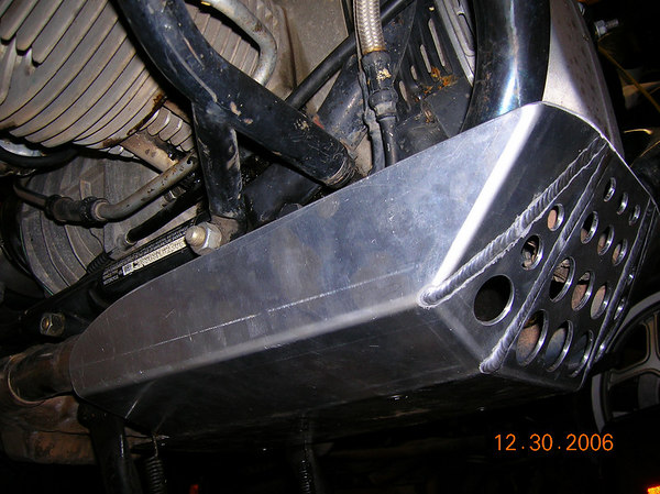

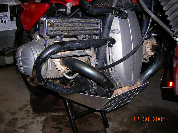

i think the simplest way is to make one - need someone to weld aluminium. like this R100GS one [attached pictures]. friend just made one for TT-R230. flat plates - no bending, just welding.
or get a plastic one - Hyde Developments - and modify it - you can bend them, mold them with heat.
http://www.hydedevelopments.co.za/

PostPosted: Wed Jan 10, 2007 4:39 pm    Post subject: Home Made! Reply with quote
Survived a crash in Bolivia!!!!!!!!!!

Hoke
Joined: 07 Feb 2005
Posts: 56
PostPosted: Wed Jan 10, 2007 5:01 pm    Post subject: Reply with quote
Thank you! Exclamation Exclamation
Great, you just gave me an really good idea! Very Happy
That is the way a skidplate should look like Cool
You is also using MT21 as front tire -i think that it works great for this bike as an "allround"tyre
