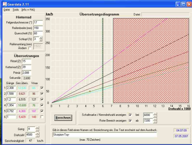

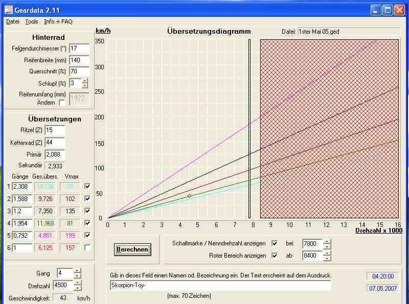

Running 15/44 with a BT090 140/70 2.6 atm at the back, my DET 100 tells me that I shift into 3rd at 90kmh, into 4th at 125-130, into 5th between 145 and 150. I went out on May 1st and onto the expressway to wind it out. The DET showed 182kmh at 7900 and it was not flat out yet. Turning the grip further brought noticable power gain until the limiter cut in. IOW, The shorter final ratio coupled with the higher revs is actually faster in top speed than the stock setup. Granted, my Toy is anything but stock, but in my nearly stock red Sport, The bike would reach the limiter at 8400 in 5th with the 15/43 but not with 15/39. I have not seen a stock Skorpion yet, that will run into the limiter with the long final ratio. Except downhill. Attached is a gear chart of the stock setup (except for 1st which is the longer 1st of the SZR).
You can see that even IF the bike will run into the limiter at 7200, it cannot possibly be faster than slightly over 180kmh.
Above that is the chart for my Toy.
