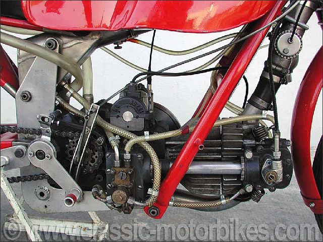

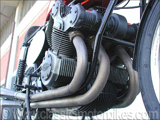

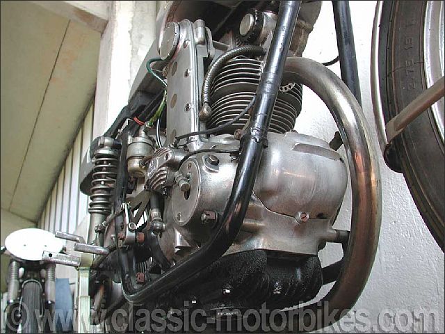

The only car I can think of right now, besides a Porsche, is an early 50ies 300SL. But that was only the racing version. The usual gull-wing has a normal wet-sump.
re oil change in the various dry-sump Yamaha singles:
It is a good idea to add about 1/2 quart right into the head thru the back, larger rockerarm cover. Only really necessary when the engine has been stripped, but if it was allowed to drain over nite, it won't do any harm, either.
My 54 BSA is also dry-sump like virtually all English bikes back then - and lots of others, too, like the German NSU Max. Many Italians, however, have a hybrid dry-sump.
They have a separate finned oil "pan" under the engine which is usually quite large. The bottom of the crankcase itself is usually closed except for a smallish drain hole to the pan below. The oilpump scavenges thru a pipe into a sieve on the bottom of the "pan". Others include the Motobi and Aermacchi flat singles. These have, unlike the Mondial, vertically split casings and the oil pan is not a separate part.
Ducatis were always "wet."
Attached below are a couple of pics.
 Description:
notable exceptions are the Guzzi flat singles that were always dry. Street bikes have the tank within the gastank. Here in this 1951 350 SOHC GP racer, the frame contains the oil.
