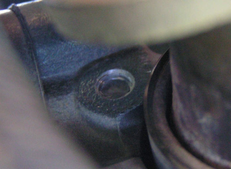

PostPosted: Wed Sep 22, 2004 7:01 pm    Post subject: Broken stud on exhaust flange Reply with quote
This a closeup of what's left of the stud. How do I go about replacing it? or would MZ cover it?

looks like you need a good mech. thats been there done that
tool required is called an easyout
a small hole is drilled in the center of whats left of stud.... easyout tool is driven
in and remains are turned out as normal
i recomend you have a good machine shop do it
as this not a job for some one who uses the big hammer method
on things Sad

that's exactly what i needed to know. thanks david. i wish there was an mz dealer within 100 mi.

If you lan to do this yourself with an Easyout, be VERY CAREFUL. Many engineering companies will tell you of the hundreds of times they have had to remove broken easyouts from studs such as these...........
Would be easier and cheaper to go to a local engineering shop and offer them cash to remove it for you. With the right tools and knowledge, it is an easy, 2 minute job. Maybe cost would be £5 or so.
Personally I'd take it back to MZ, by my dealer is situated on my way in and out of work, so no problem. If he was 100kms away, I'd do the above.
