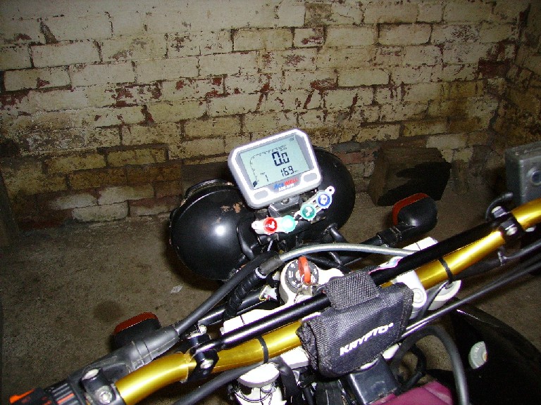

Fil
Joined: 22 Jul 2005
Posts: 144
Location: Shropshire, England
PostPosted: Mon Jan 23, 2006 12:29 pm    Post subject: Reply with quote
Here's a pic (if it works!!)
The engine is not running, so the revs are zero, but you get the general idea. Also, please excuse the idiot lights which are temporarliy ziptied to the speedo mount. I should have spend the extra money to get the speedo with built in idiot lights I guess!
