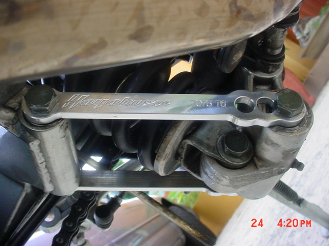

I'm trying a hayabusa dogbones for my skorpion, fits very good and gives 3 height options...

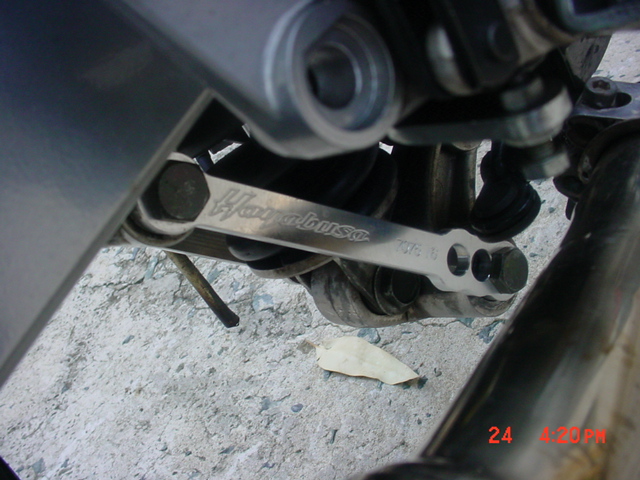

Please see photos attached... dog boe part# hayabuza 7075 T6 ...
 Description:
Dog bone for Skorpion Tour 660cc
(Hayabusa 7075-T6) MOTORCYCLE
 Filesize:  149.21 KB
 Viewed:  1846 Time(s)
 Description:
(Hayabusa 7075-T6)
 Filesize:  153.11 KB
 Description:
(Hayabusa 7075-T6)
 Filesize:  158.37 KB

Nice!! Thanks for the trouble Cob.
I'll have to get a pair.
